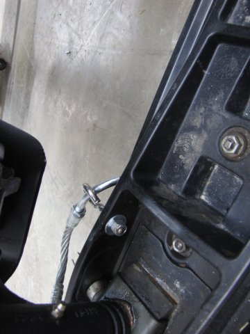

Installed some Ice Scratchers. Mounted them on the skis to maximize snow dust going into the skid. I cut some metal plates to mount inside and outside of the ski.
I also indexed the scratcher's mounting surface so they will not rotate. Sorry no pic of that. Used an eye bolt to park them when not in use.
