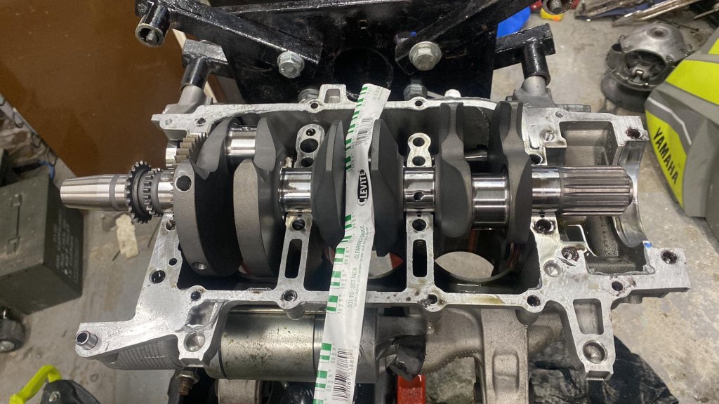

Just wondering if anyone on here built a stroker 998 ? How is it for tuning and what does it run like ? My build list for this season and parts are already ordered are Brian Crower 4340 billet stroker crank (1071cc) , Brian Crower MOAR rods with larger piston pins , Cp Carrillo 8.5.1 pistons , Kibblewhite black diamond stainless intake valves , Kibblewhite white diamond inconel exhaust valves , Brian Crower stage 3 turbo cams , ARP case studs and new arp 625 head studs and hypersports ecu . I’m pairing this to my big turbo mcx stage 4 build which I will link here

Just wondering if anyone else has done similar and has any dyno numbers or any tips for me .
