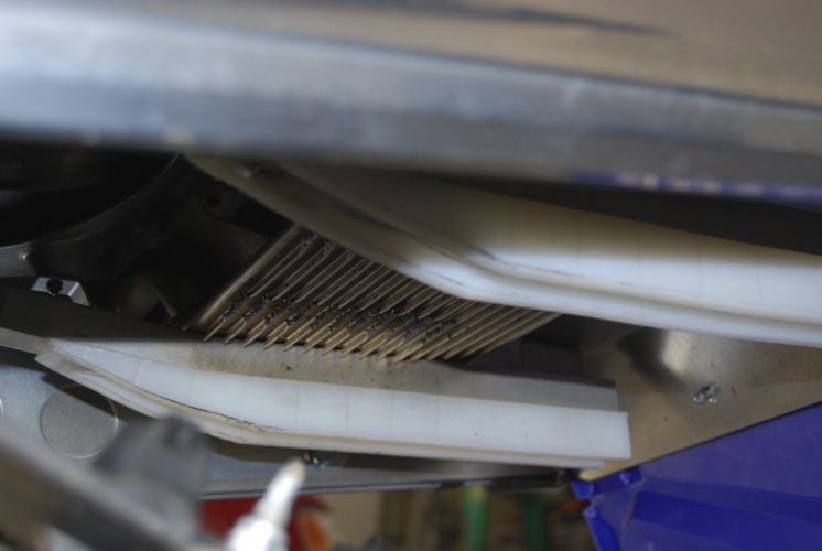

I have a 2009 Attak with the rear heat exchanger and studs. First ride I took it on the studs hit the exchanger and although visually damaged it did not puncture. The best solution I saw on this site was to take some hyfax and cut them down. Then attach to the existing tunnel protectors. Works great. I will try to post pictures tomorrow. They do the trick and the solution was simple and inexpensive.

How much did this add to the protection? How many fractions or whole inches? Keep us posted if this works still after a full season. Just curious how much clearance needed on these LTX's with OEM installed coolers. On mine they didn't have them OEM we had to go aftermarket and we need 1 1/2 in. of protection along the cooler or it will hit. Maybe not right away but sooner or later it will hit with out the full 1 1/2 in.

Picture of Tunnel Protection
Here is a picture of the tunnel protection I made out of hyfax. I have run it for a season and once this was on the studs no longer came in contact with the rear heat exchanger. You can see the original damage without the extra protection, just glad I did not puncture. I have never had a problem over heating.[/img]
