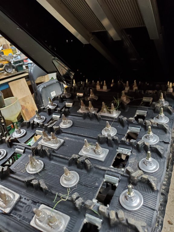

Are all those studs for ice racing or just trail riding?This is what my quiet track looks like now...

This is just my experience with the plastic backers. My buddy I ride with buys a new sled every two years and he gets the plastic backers. The last two sleds he’s had I’ve had to climb under his sled and tighten a loose stud during a ride. I’m not saying they’re junk, I’m saying you need to keep a close eye on them for loosening more often than the aluminum backers. I check and re-torque my studs before each season and thats it. Nothing more needed. Just my opinion. Someone else may have a different and more positive experience.Youd have to purposely ride like a physco and do stuff you shouldnt be doing to studs like spinning on rocks or curbs etc to damage one of those pro lite backers! Super tough if installed correctly. I would not use them on a quiet track without cutting the pads down just because there is not a metal thread to be screwing the studs down, its just plastic so itspossible you would strip some backers trying to get studs seated flush. Maybe it can be done but personally I felt more comfortable cutting the pads down. With that being said the 2022 winder is getting conventional studs as the install is quicker and price is cheaper.
