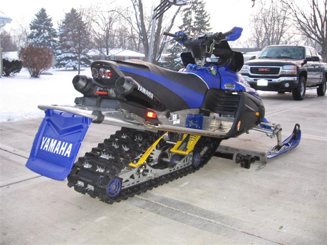

i'm looking to stud my 04 warrior it has and excell exhaust, k&n filters and the stock ripsaw track. how many studs should i put in my track?? and what about tunnel protectors?? i weigh around 380 and bottom out from time to time, this makes me worry about putting on studs!!??

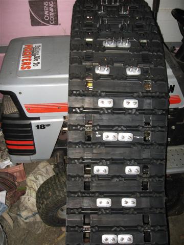

i go about 320lbs. and i just put 108 double backers down the center. 1.4", bought them from rich motorsports. 108 gives you the enough hook-up and braking power without being over bearing and tearing apart the track on a few years. protectors should be there unless you have the aftermarket cooler in the rear, then you have to fab your own.
