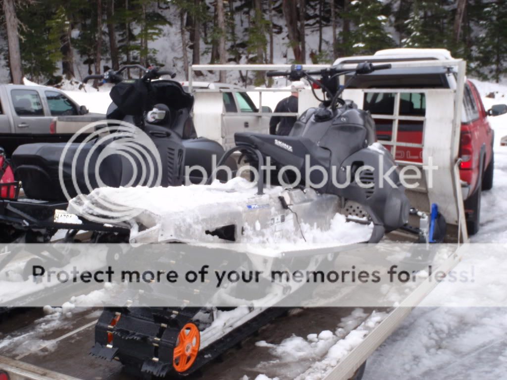

I'm going to Poach Drew and Caleb's thread and post my sled rebuild. As Allot of the Local riders herd last weekend my Sled ended up taking a 200 foot drop into a ravine. We were able to go in the next day with a new real axle and A buddy that was very familiar with the area to break A trail to get my wounded Nytro out of the bad spot it was in. The damage report looks to be
Tunnel
Rear torque arm
Rear axle
Skinz under seat bag tore off and got lost in the pow
Drivers
So here are some pics of the start of the project I figure I have 3 weeks to get it together and have a couple weeks of riding before Yamaha fest
On the trailer after we got it out
