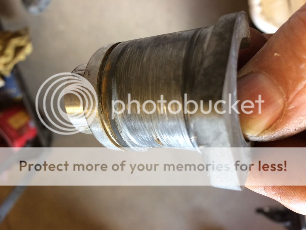

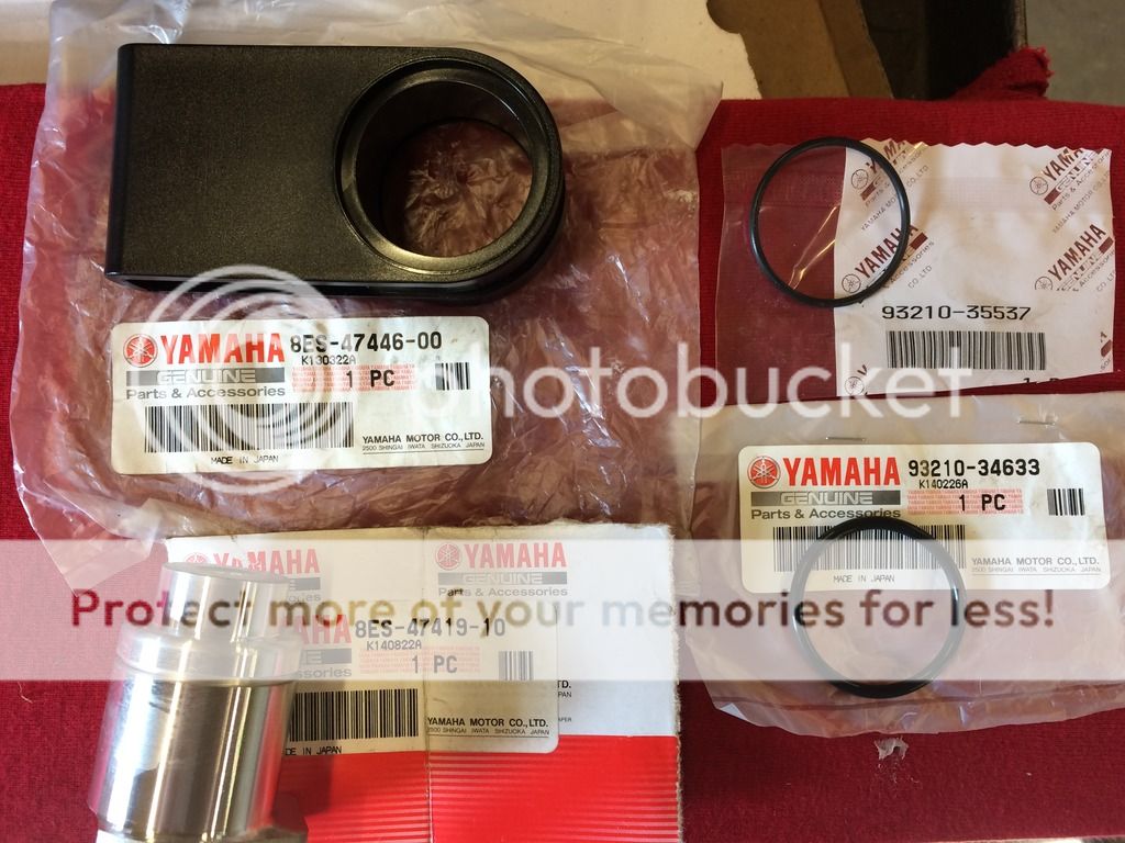

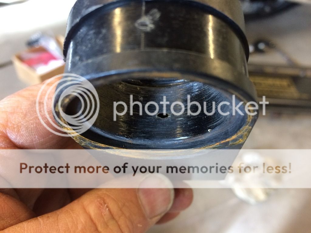

Also check out your torsion spring saddles and idler mounts. They wear out over time and can cause issues. I just replaced a set and took a few pictures.
