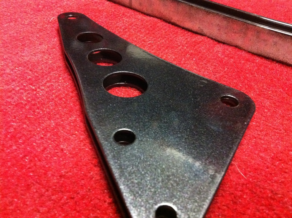

I went with Harley Davidson black pearl on my a-arms, rails, spindles, and more.

LOL, they do when done with some class and style. I've seen sleds/cars/trucks with huge metalflake paintjobs like you see on bumper cars and it looks terrible.
