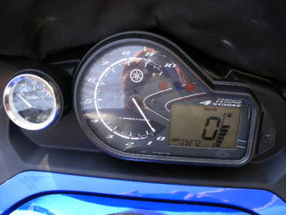

You can do the flush mount but add a piece of ABS pipe under the gauge ring on top of the dash. This would make the face of the gauge even with the speedo / tach face and give you your clearence underneath.

I would opt for the surface mount temp guage from Ulmer...

Handy said:You can do the flush mount but add a piece of ABS pipe under the gauge ring on top of the dash. This would make the face of the gauge even with the speedo / tach face and give you your clearence underneath.
This is what I did, worked perfectly.
vogelm1
Nice install!! I almost like that better than the flush mount - seems to compliment the meter a bit more. Think this is the way I'll go. Appreciate all the input guys!
