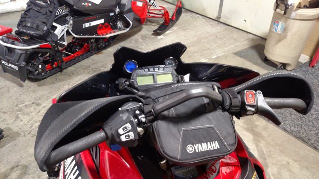

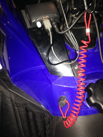

Where on the sled have you guys installed the tether switch? Not that it cracks or breaks any plastic, where is a good place to install?
I put mine here.
This is where I have mine just to the left of the Gems controller and below the horn button - YES I said horn
They are basically plug and play. sorry I can see it on the pics on the computer.

This is where I mounted myn
Thanks for posting the photos.
