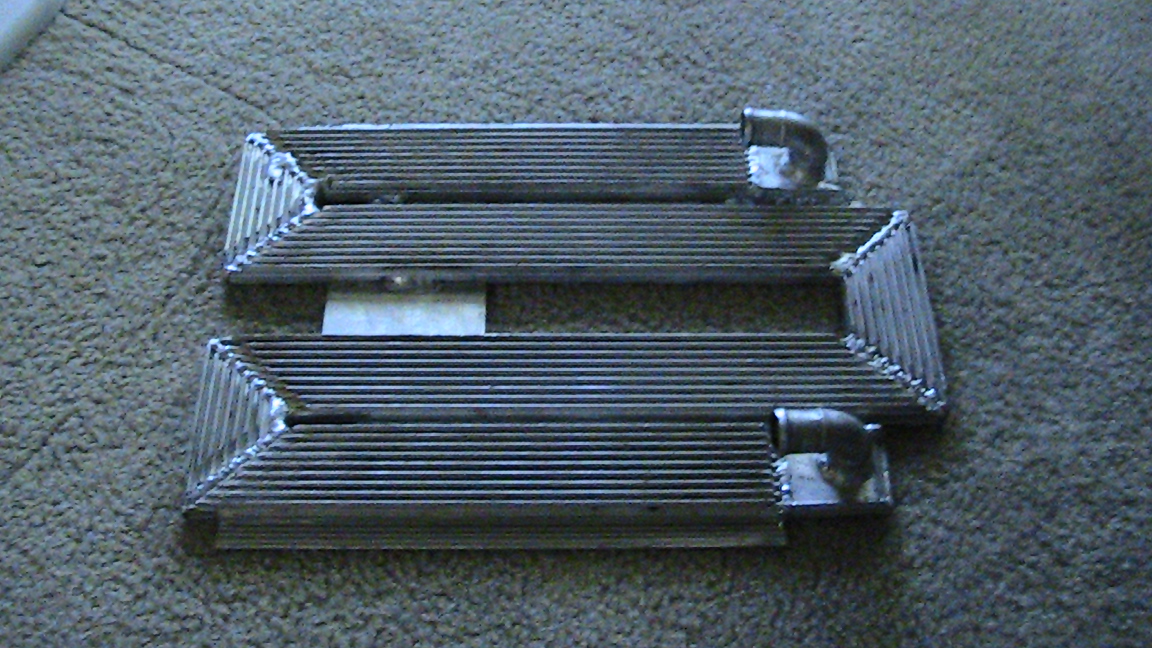

Well, like I have said many times, it ain't pretty.
I hacked up my take-off running board coolers. Can't weld so I had that done, felt so sorry for the guy, he was chasing pinhole leaks for hours - probably from residual antifreeze contaminating the welds. Pressure test OK. Am hoping that there will be minimal flexing of the tunnel extension when I ride 'cause I am not sure how much punishment that this thing is going to take.
Will post higher quality pics of the install later....
