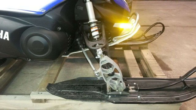

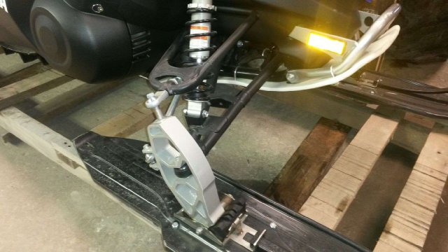

So I was looking at my stock a-arms and was wondering if anyone has tried this before or if it would be a waste of time-
I was wondering if you could flip over the lower a-arms and bolt them up and Then weld a shock mount on the a-arms. It looks like it could push the skis forward from their stock position if it would bolt up.
Has any one tried this or is it even possible?

I don't think flip them would work because of the ball joint angle

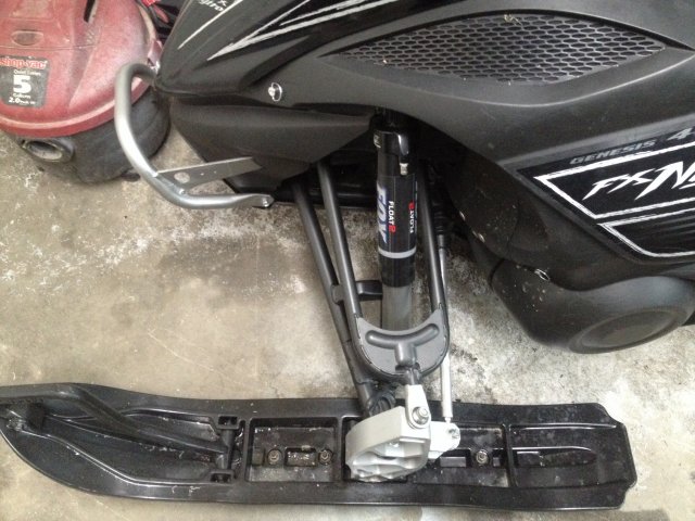

I did modify mine, but don't know if I got the pic right
Just get the Barcode kit. Its totally worth it. Super cool looking, fixes the stupid "pogo stick" shock angle. Makes the Nytro a pleasure to ride.
Your absolutely right, not all of us do. But if your on the fence and are going to put a couple of $$ into the nytro. The Barcode front end is what you should be saving for.
