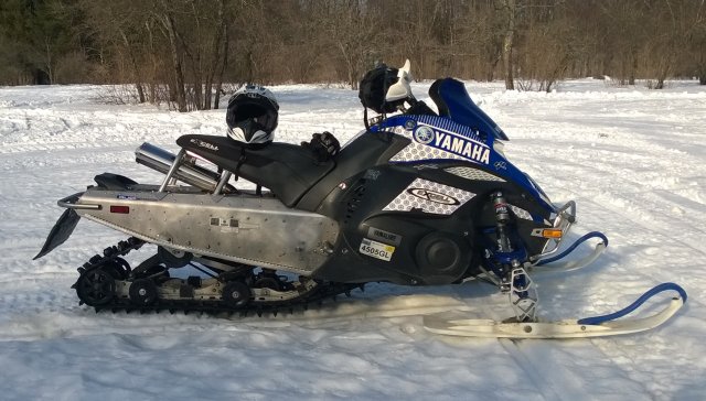

I can't tell you if it is worth it or not. I never rode my sled or any Nytro for that matter enough time to make a real opinion when the suspension is in the stock posistion. What I can tell you is that I can ride this thing like my old SXR and that front end stays flat!! I do not have the inside ski lift like everyone complained about with the stock Nytro. There has to be a reason that the Yamaha CC race team moved the suspension back! Do you think it might be handaling?
Now I'm trying to find the cash to rake the front end with a mountain Tech 43+2 kit! Then a OFT relocate,WRP seat, Grizz gusset and oilight bushings! Where do we find the funds.....hmmm!

You don't need rail extensions if you go with the star relocation kit ($130 Canadian) and if you got a smoking deal on the track hold onto it and sell it in the fall. I love my 128- takes the bumps so much better and is a million times better on lake with slush and loose snow. This is the only mod you are missing from your sled
Tyloooor
http://starsuspensions.com/fxnytro.htm just looks how different the approach angle is.....

I'm not sure way you'd want a 1.6" cobra for 90% trail riding. If you are looking for trail performance spend the $130 for the relocate and stick whatever track you want on it. With the 10% off trail you'll see improvement there also. Going with just a 4" rail extension to accommodate the 128" track doesn't improve performance near as much as the 4" relocate.

I run a 129" 1.6 ice cobra, Im 90% trail rider, and I freaking love it. And do the skid relocation, man it is so much better.

Oh, it works way better, I also had my shocks done by Hygear and a dual rate spring installed. I had 2 nytros up untill a few weeks ago, 1 stock 121" and my sled which had the relocate done. so I could swap with my wife when out riding. It is a clear difference in the bumps and handling dept. IMO the nytro is just too short which leads to a poor handling machine..
