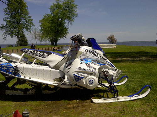

I was just hoping to see some pics of Nytros with painted plastics (preferably white). How did you go about painting them and how did they hold up?

I've painted mine for my Guinness attempt sled.
So far they are holding up great even after multiple times of sealing panels with Gorilla tape & removing it.
I used Krylon Fusion gloss white, Krylon Diamond Dust, & Krylon Fusion clear.
I have about 30-40 hours into painting the plastics, sanding, & prep work
