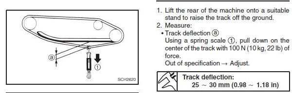

How much track slack am i looking for?sounds suspension related. If it was the track, it shouldn't ratchet as much in powder but if it is the track, you should also feel it is a loss in drive. The suspension unloading you would hear whenever the skid is not in solid contact with the ground. The track is easiest to diagnose. Lift the back of the sled up off the ground on a stand and you can see and measure the track sag. While the rear is in the air, reach in and grab the suspension components, you should not feel significant play anywhere. inspect the w arm, they are known to fail.

FYI, become a VIP on the site and one of the membership perks is access to the service manual for your Apex.

‘07 Ape RTX had the CK skid…..as they collapse this skid loses track tension, very important to run it at Yammy spec. When you’re in deep snow and grab a handful the rear arm collapses quite a ways depending on how your transfer is set on the control rods. The high load of the deep snow combined with the collapsing suspension rear arm = track ratcheting with this skid. Been there, done that.
