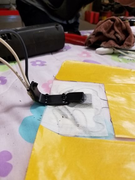

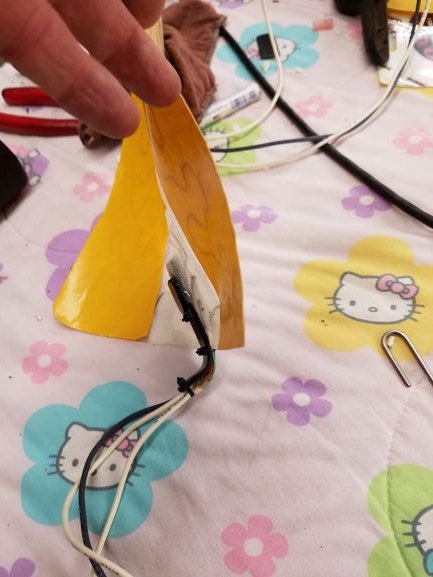

Hate to tell ya but because of the design of the seat heater, it will fail again, and again, and again IF nothing is done to stop it. The wires flex right at the power chip causing them to eventually break (ever bent a wire coat hanger back and forth a bunch of times? Eventually they break).
The solution is to prevent flexing there. I have repaired 3 heated seats so far. Changed lead wires to super-flexible wire (from McMaster) and fabricated a plastic support piece to attach to power chip and prevent wires from flexing there. Problem solved.

Sounds good. The plastic support guides the wires down into tunnel in the seat and that's where you want the lead wires to flex (not at the power chip). I used super-flexible wire and then provide some slack in the seat tunnel, like maybe form a spiral or serpentine with wires so they can flex while you ride.I'll talked to dealer and see if they will give the original heater and I'll do a similar repair as you did and keep it as a spare
