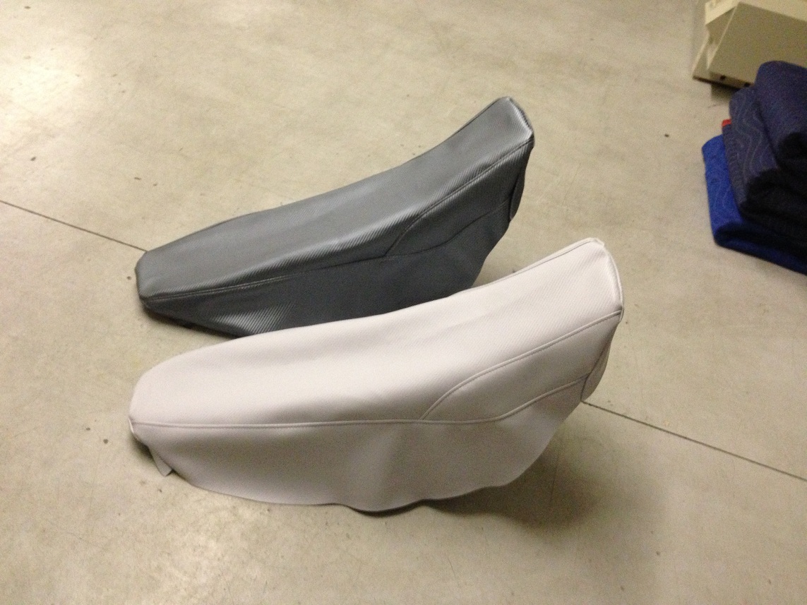

Well we have now got the ball rolling on the builds, it will be a couple more weeks before we really get humming on these but we have started.
Just as a re cap these are 2009 high KMs fleet rental machines, that are exceptional well maintained.
So far we have gathered 2 new 153 take off tracks, one complete set of nytro shocks (which we will be modding to work for one machine) the other machine (for my wife) will keep stock suspension. We also got the super charger for the one machine and we have started collection most of the parts for the meth injection kit.
Our sewing department has just finished our seat covers 1 in carbon fiber white and the other in carbon fiber grey. They turned out exceptional and we will be attaching them shortly to show the final result.
Then it will be on to tearing everything down for powder coat and then start on building two sets of new running boards.
Stay tuned we are just getting into it!
