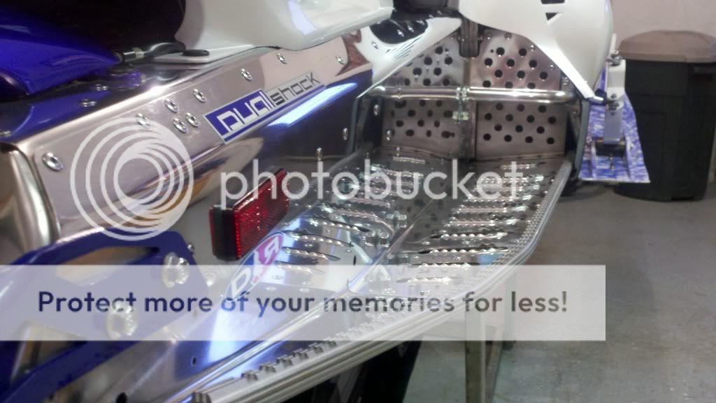

mcamzr said:Not trying to short cut here but is wet sanding a must with a tunnel that is brand new?
Mine came out good without sanding. If you are very patient, have lots of time and want a perfect mirror finish do the sanding but for finish that looks good from 4 feet away the buffing alone works fine.

2BLUE4U said:You have to wet sand to get best results and using wheels, drills, etc. doesn't work...doing it by hand is the only way. Anyone at a trade show showing their "wonder polish" that just wipes on and wipes off, is full of crap...there's no such thing. If you want a mirror finish, plan on spending 10 hours plus.
These surfaces were done in ten minutes with no sanding. It's not a perfect mirror finish but it's not a show sled either and a couple of hours on the tunnel with a buffing wheel makes a world of difference.
