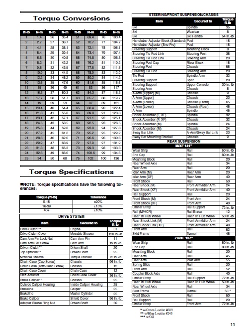

Anybody know what the torque spec is for the front shock mounting bolts on a LTX SE with Fox floats? I was going around my sled just doing some general bolt and fitting tightness checking and found what I thought to be the shock bolts a bit to loose so I tightened them. Turns out that maybe they were right from the start as the front susp. didn't want to move to well after I tightened them. Just did it by hand, no test ride. So I them backed them off and everything is fine now, but I would like to put the nut/bolt assemblies at the proper spec.

Thank you Cannondale, it appears that 32 lbs-ft is it. Everyone keep that in mind, as you CAN get them too tight!
