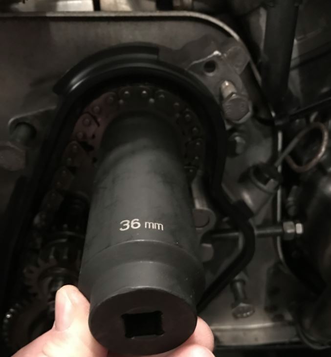

X2 on air riveter and most times you can find an inexpensive one at your local Harbor Freight. Also, if wanting to re-torque the nut on the top gear in the chain case, you will either need to find a deep well 36mm socket like the one I have or make one (redbeard makes a post in this thread on how he made his).
- 2,188

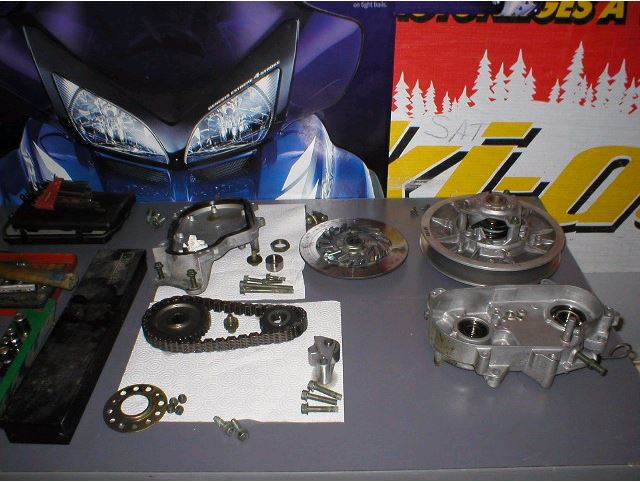

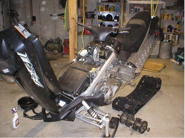

Those last two images weren't of my RX-1. Although, it is black, I added reverse to it after picking the RX-1 up from dealer. Would have had dealer install it the OEM kit but then Yamaha would not cover it under their Y.E.S. so I opted to do it myself. My dealer was cool and understood and even provided me with the pages from the service manual which helped a ton. Now, I can disassemble/reassemble the chain case like back in the day of Happy Days where Fonzi reassembled his motorcycle after loosing his vision. If you become a VIP on this forum, one of the perks is having access to a service manual.

Can you tell me the length and depth of the 36mm socket that you have? I’ll find one locallyX2 on air riveter and most times you can find an inexpensive one at your local Harbor Freight. Also, if wanting to re-torque the nut on the top gear in the chain case, you will either need to find a deep well 36mm socket like the one I have or make one (redbeard makes a post in this thread on how he made his).

Here's a link with the dimensions.Can you tell me the length and depth of the 36mm socket that you have? I’ll find one locally

Then the image of the chain case disassembled on the bench will be very similar to what you will find in the Nytro; reverses just has an extra bottom gear and those two smaller inter-locking (ie. sort-of) gears.The RX has reverse, the Nytro does not
