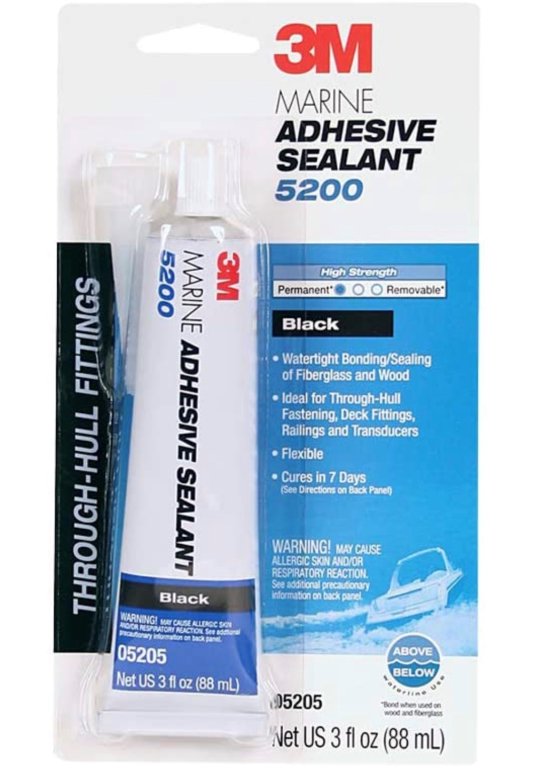

Well, if you decide to repair, curring time will be your best friend for best results. This is the 3M waterproof sealant that I've used. Your damage does not seem as bad so if anything, I would use something like this to just 'patch up' that area so as to prevent it from fraying/delaminating further.

I'll check that out. I was also recommended loctite 404Well, if you decide to repair, curring time will be your best friend for best results. This is the 3M waterproof sealant that I've used. Your damage does not seem as bad so if anything, I would use something like this to just 'patch up' that area so as to prevent it from fraying/delaminating further.
