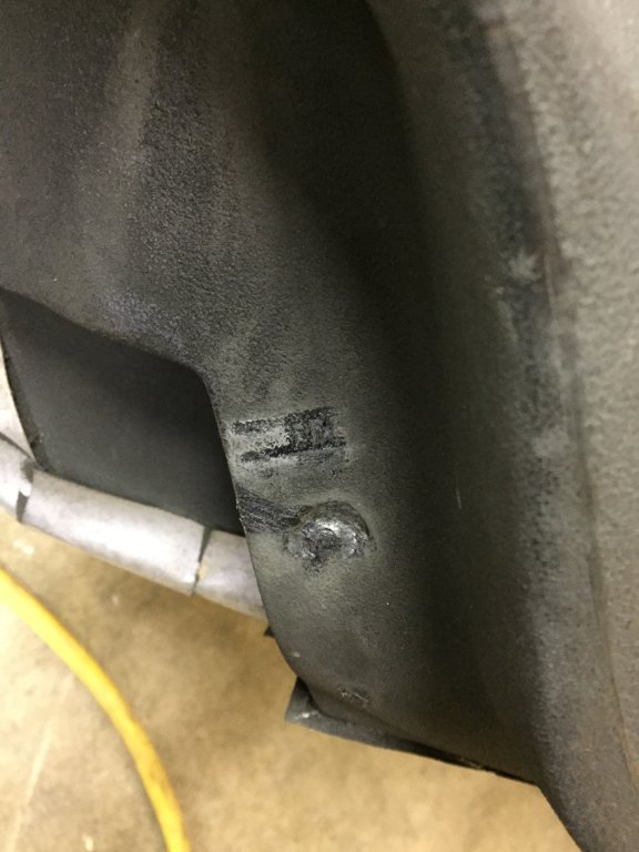

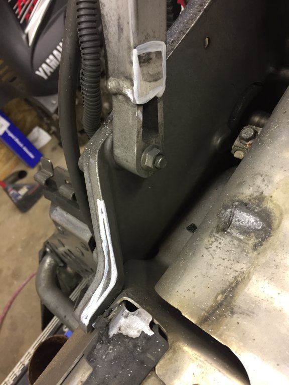

My son just picked up a 2009 Nytro xtx, that previous owner installed a trail tank. We were going over the sled and noticed the trail tank just didn't sit just right. Pictures show two spots almost rubbed through. The weld from cast to the tube was rubbing on the tank. Just a warning for other trail tank owners.

Good call, I have a 2009 XTX with a trail tank, does not look like it fits too well either. I think these early versions of the trail tank didn't, there was an earlier version I think that was even worse then a better version, but not sure year that came out. Looks like your wear points are up near the heat shield, I'll check mine... see if it is systemic or a one off on your install.

My son also has a WRP seat could also contribute to the problem but it looks to be the tank to the square tube support for steering has interference.

Wife's XTX has both tank & seat with no fitting issues.
Dr. FeeLGooD
I have to pull mine(version 2) in with a ratchet strap. I put on 11000 miles like that.

Thats funny, i do the same thing.I have to pull mine(version 2) in with a ratchet strap. I put on 11000 miles like that.
