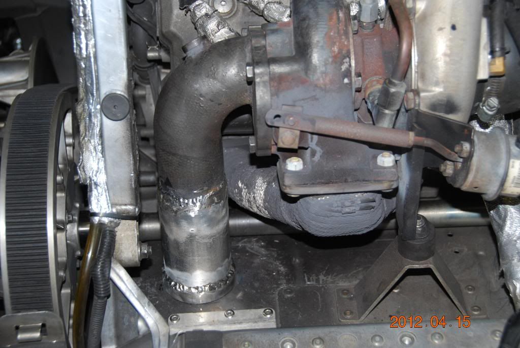

That's a nice setup, i have a front mount so a little different.tjc said:I have a small muffler with a tunnel dump. No issues so far.

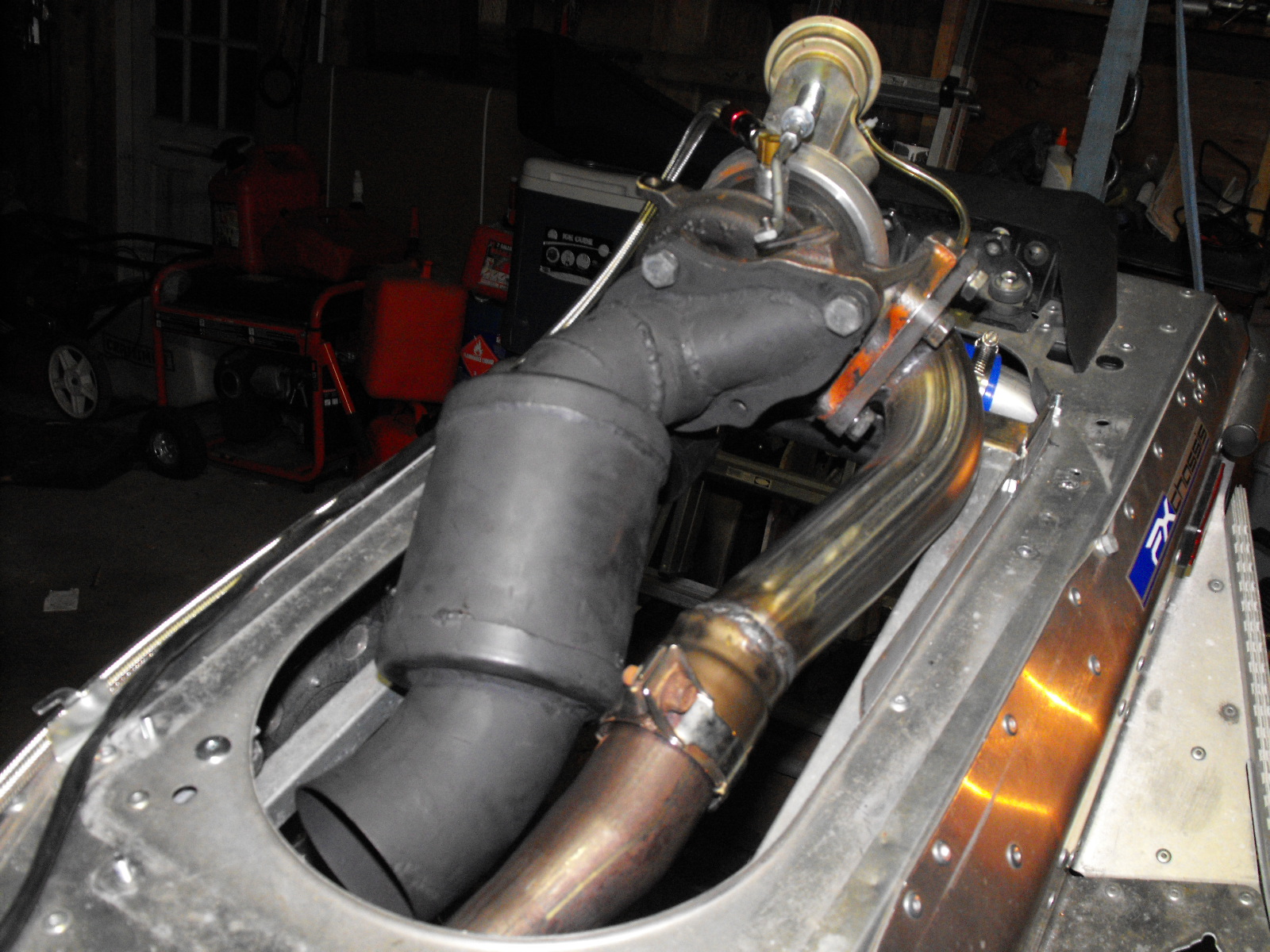

Just finnished setting up the exhaust, no muffler and straight from the turbo a 2 1/2" pipe about 12" long going straight down through the bulkhead behind the jackshaft. It dumps on top of the track.
lund
Here are a couple of pic's of the setup.
brad4639
