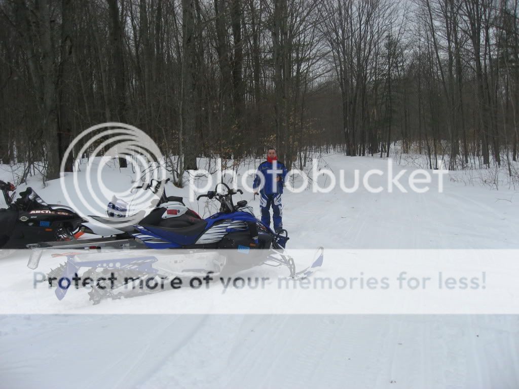

Hey I am new here. I just aquired a '07 Phazer FX that has a rail extension on it and a brand new 144" track. What I am trying to do is get the factory extended tunnel on it I bought the MTN's longer bumper, a new snow flap mount since the old one was sucked into the track and tore and I got the flat piece that covers the gap that will be created. All Yamaha parts. I was just wondering if someone had a picture of bumper and rear part of the tunnel on the MTN Phazer handy. I am just wondering how the new flat extended tunnel piece mounts, if I need to fab up and angle into it to mount it to the original tunnel, or if the new piece comes with it. Thanks for all the help in advance looking forward to looking around here since there are not many Phazer riders out there especially up here in Polaris and Arctic Cat country.
Here is my sled how it sits.
T.S.U.Filmz
you will have to pull your bumber off and get a longer one also will have to fab up a tunnel EXT for your flap to mount to

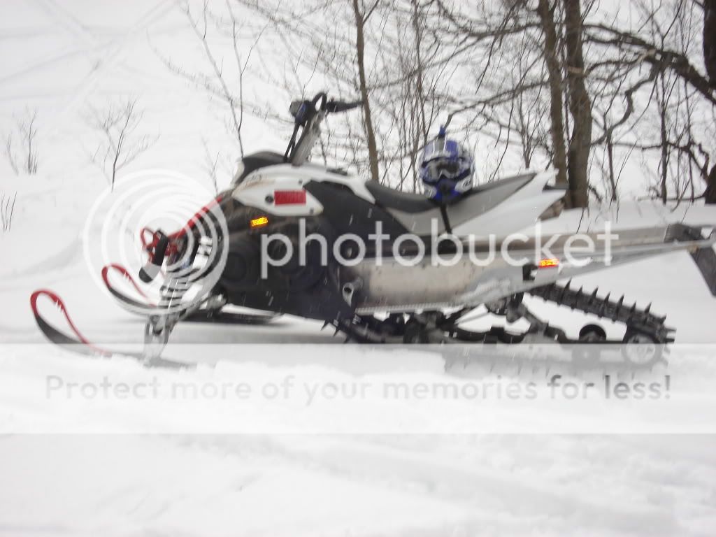

here is a pic of my MTX hope it helps

yea that is why the flap is folded up and tied in the first pic the last guy hooked it and tore out the flap mounts and tore a little of the rear AL. And it would be hard to lift it out of the deep snow when the rear handle is a foot in of the rear of the track.
