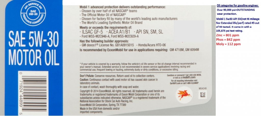

Joe....I did some extensive reading as I like to do every few years on the oil subject. I have researched Zinc levels many times, and there is less evidence that Zinc is as important as we all once thought. I used to always look for Zinc levels over 2500ppm, but now it seems 800 or so can have very good wear ability , due to other factors that help. See below.
Im a cheap bugger, and luckily with Walmart and Mobil 1 we seem to be able to get cheap and top notch.
While much of my reading shows many time, that the Pennzoil ULTRA has the TOP wear rating, its not easily found and when it is, its not cheap at all! But its nice to see good ole Mobil 1 rates VERY VERY high in these same wear ratings. It came in 3rd place in this test below, which I have seen similar tests around the interwebs.
Mobil 1 5w30 is the one. Not high mileage, NOT extended life/perf....Just the regular Mobil 1 5w30. API SN. I have used Mobil 1 now in many sleds and also other toys, lawn tractors,blowers ect ect....it has always worked well.
5w30 works well for most all winter temps. Now if you leave your sled outside in 30-40 below temps, I would want something thinner, but for 90% of us, 5w30 works great.

1. 5W30 Pennzoil Ultra, API SM synthetic = 115,612 psi
I have not been able to find this oil with the latest API SN certification. The bottle says, “No leading synthetic oil provides better wear protection”. For once, a product’s hype turns out to be true. And this oil provides MORE THAN TWICE as much wear protection as the lowest ranked oil on this list.
zinc = 806 ppm
phos = 812 ppm
moly = 66 ppm
2. 10W30 Lucas Racing Only synthetic = 106,505 psi
zinc = 2642 ppm
phos = 3489 ppm
moly = 1764 ppm
NOTE: This oil is suitable for short term racing use only, and is not suitable for street use.
3. 5W30 Mobil 1, API SN synthetic = 105,875 psi (NOT Hi Mileage NOR Extended Perf)
zinc = 801 ppm
phos = 842 ppm
moly = 112 ppm
Dan
zinc = 801 ppm
phos = 842 ppm
moly = 112 ppm

And I grabbed some online recently, free shipping for 2 at Jet.com....Started at $22.88 which in itself is amazing but then down to Approx $19.66 each after rebate.

the 0w30 and 0w20 mobil 1 weights never test as good as their 5w30 from mobil 1. They both have less zinc in them at 750ppm(according to their own specs but even less in independent tests closer to 650ppm only).....Even a few mobil 1 in that list are far lower rated. I have always stuck to the proven data and at that price I am happy.
I had read many times that its because they are more mainstream for the new cars and top EPA MPG ratings....the first number is simply for cold starting, so no need for 0 weight unless you park it outside in 40 below always. which I have rarely done.
I try to stay away from the norms for autos....they just dont test as well.
That being said, NOONE is gonna have a motor go down from oil brand choice, so just use whatever you like and change it when its time. And all will be well.

Thanks Dan I just ordered two jugs of Mobil 1 5w30 and two K&N 147 filters.the 0w30 and 0w20 mobil 1 weights never test as good as their 5w30 from mobil 1. They both have less zinc in them at 750ppm(according to their own specs but even less in independent tests closer to 650ppm only).....Even a few mobil 1 in that list are far lower rated. I have always stuck to the proven data and at that price I am happy.
