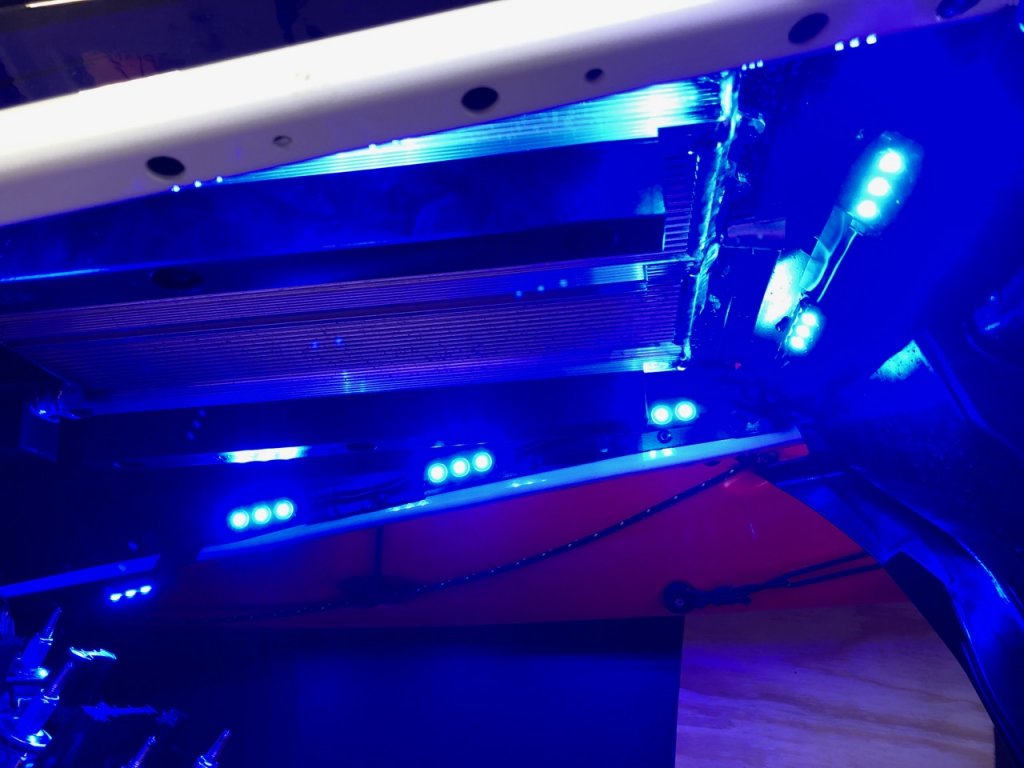

Super tough to get good pics of how the lighting looks unless I use my real camera - which I may try and do this weekend. I've used a couple different kits over the last 3 years and this is by far the most durable, I have them inside my tunnel with over 2000 miles and were still going strong on my '17 when I wrecked it. In fact I pulled some of them off and they're now on my '18 in these pics.
Kit - http://www.stratusindustries.com/siproducts/snowmobile-led-hood-track-lighting-kits

I'll chime in on anchoring the wiring - both in the tunnel and under the boards (though I use the same for under hood). The kit I have uses 3M double sided tape, that holds the LED pods pretty securely but I also use 3M weather stripping adhesive to secure the wires to the tunnel or boards and than after that dries I use Flexitape (the as seen on TV stuff) which I purchased at Home Depot. The Flexitape is prob a joke if you use it on a boat hull like the guy does in the commercials, but for this kind of application it's awesome. SUPER sticky and basically a thin sheet of flexible rubber, so it holds like crazy and offers a LOT of protection to wires and the edges of the LED pods.

LOL - good catch Colombo! But you wouldn't have completely solved the murder.Beerman did someone steal your right rear bogie wheel?
A few pics are prior to track swap/studs/Stealth Big wheel kit install and a couple are after.
