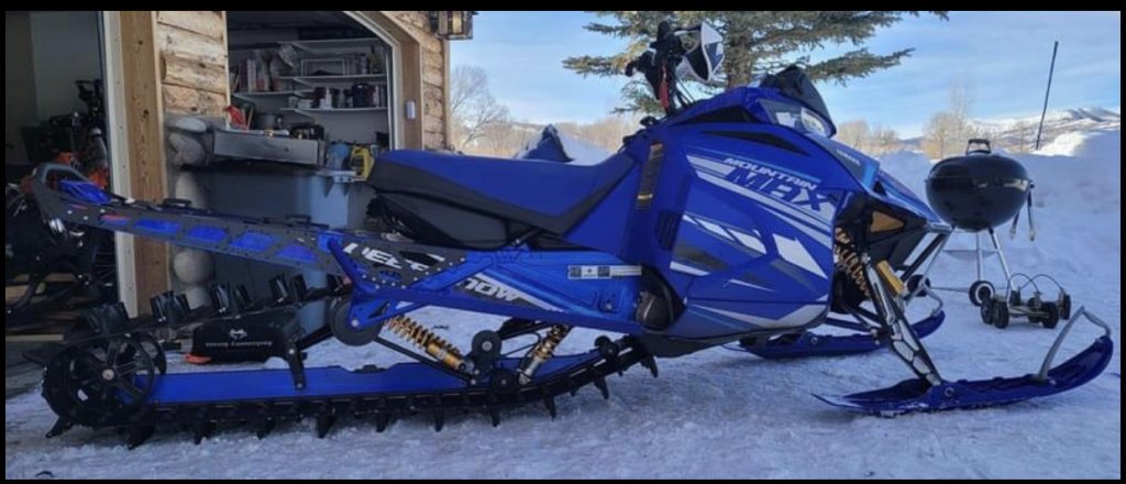

The tunnel on the transporter is the same. It looks like you’ve got a better shock package. I’ve lengthened the limiter strap and put in a center shock out of my ltx and tighten up the spring it helped a bit but still not enough ski lift for the fun factor.
Thats not my sled. Thats what needs to be done. Going to have to relocate the skid. I would really like to drop the chaincase and duplicate the Alpha exactly.The tunnel on the transporter is the same. It looks like you’ve got a better shock package. I’ve lengthened the limiter strap and put in a center shock out of my ltx and tighten up the spring it helped a bit but still not enough ski lift for the fun factor.
What are you asking here?
