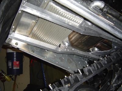

rear exchanger
you really dont need any instructions to put in a rear exchanger, this picture is all you really need.
