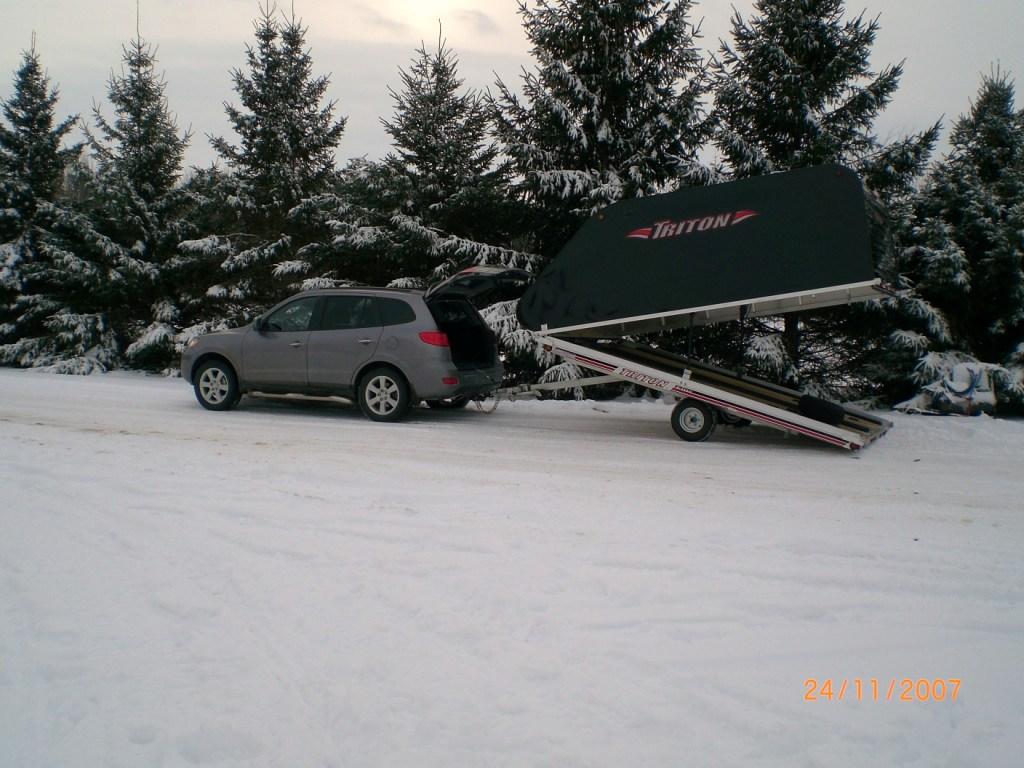

I own a 2007 ENCLOSED TRITON ELITE 12' with 20.5 x 10c tires and its rated for 2200lbs GVWR and the axle does have a upwards bow and the tires are 6 plies and rated for 1100lbs each @ 50lbs air pressure...I've attached some info my model # "ELITE12-101" trailer is 495lbs + cover 150lbs +/- total of 645lbs give or take - 2200GVWR = 1555lbs of live load div by 2 sleds = 778lbs capacity per sled.

the tor-flex axle is worn out. i have seen this alot lately. replace it and all should be fine. i have seen the 5000lb ones do the exact same thing. do you leave your sleds in the trailer in the offseason?
