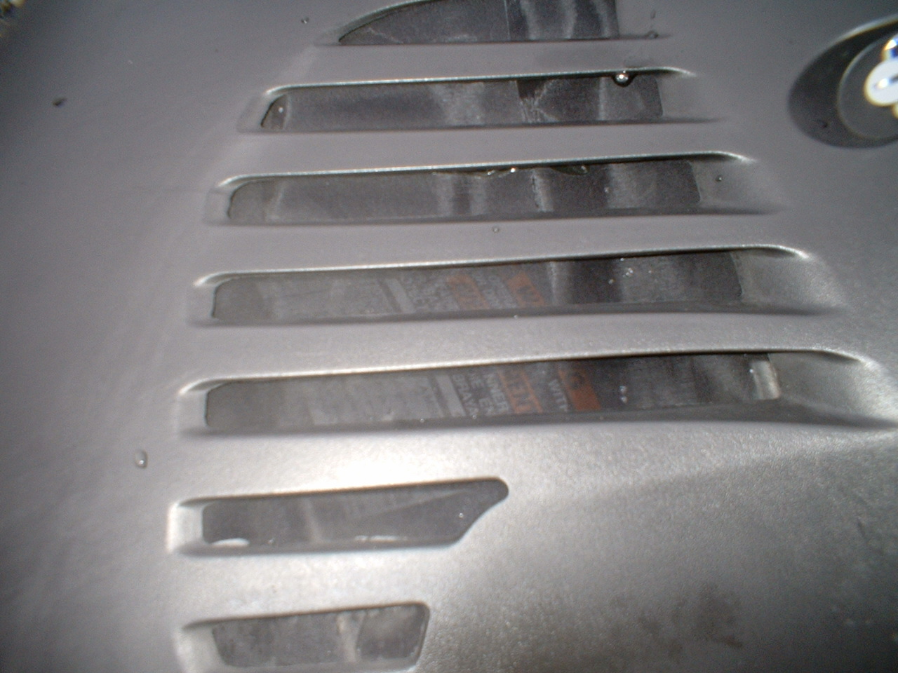

I pluged the hole by the clutches and put some prefilter material over fron vents along with some klim boots I have pants and feet.
Prefilter material on the plastic vent & footwell area fixed this issue for me.

Same as KINS.
Just pull the side panel off, put a trouble light under the sled, then grab some duct tape. Between that and plugging the hole by the secondary, everything is now OK. Yamaha is working on a proper fix.
