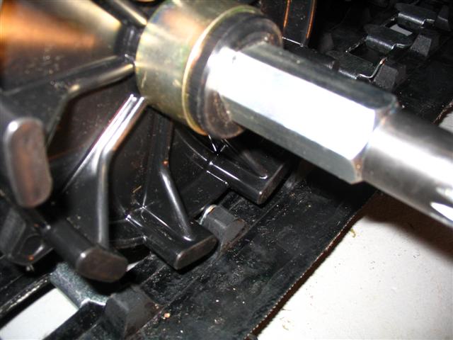

I pressed the drivers on to the new drive axle and everything fits good,except I forgot about the fully cilpped one where the clips goes to the top of the rubber lug. If I push down on the drivers they slide down to the track clip. So do I press each one down a 32cd or let them wear in.

So if I understand you right, you have the drivers set so they are centered on the holes in the track, and you're wondering if you could scoot them out a little for clip clearance? If I have you right, FWIW, I might try something like that, but not very far.

give her just a little more.

I put the Avids on mine. The drivers will wear when they hit the clips. After a few miles they will be fine. Let them wear in.

I decided to press them a little more.
