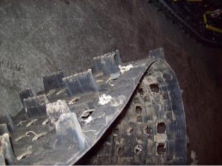

Very common in the steep and deep. It drops weight (rotating mass no less) and allows snow to fall out of the skid making the sled lighter. Some feel that it helps lubricate sllides in an opposite manner on trails.

My understanding of a Ported track is, a track that several holes (1'"-1 1/2"holes )drilled in the track to allow snow to escape and also lighten the track for less rotating mass. Trying to find a pic for ya!

Big lug track's build a lot of air pressure in the tunnel robing a lot of power, The hole's relieve the pressure. Correct? kviper

Did my old apex mtn.Wasn't really worth it.You lose a little snow but it doesn't come in as much to lubricate your slides.
