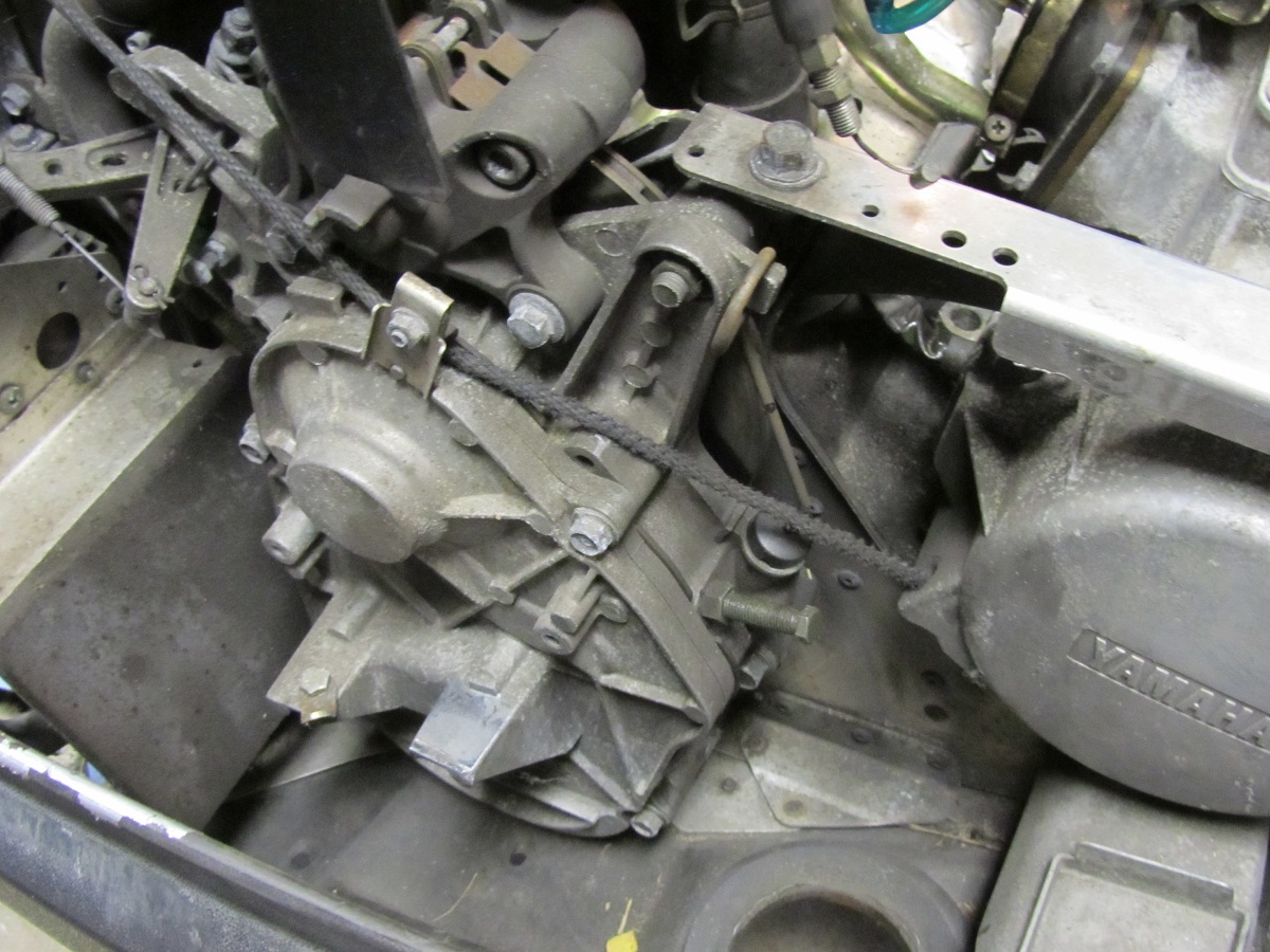

I've see lots of post on polishing tunnels, bumpers, rails... But what do you use on engine and chain case. I want to do a little cleaning on a used sled I picked up and it has some obvious corrosion from road salt and such. Is there any relatively easy way to clean up things like cylinders and chain case without spending hundreds of hours? I'm not looking for a showroom mirror finish, but I'd like things to not have that white flaky crap over everything. Besides paint/powder coating, is there a way to prevent this in the future? Attached are a couple of pictures of what I'd like to clean up.
One thought I had it a mild vinegar solution and then pressure wash. Any other ideas or suggestions?

I wonder about an acid wash? I have my trailer acid washed at the local truck stop every couple of years. I think polishing would be too long and tedious for those parts. Just my two cents.
Try foaming coil cleaner diluted to a 1/3 water 2/3 cleaner mix. spray on with a water bottle and let sit for a minute or 2. then thoroughly rinse off all areas.
I use this on both my sled and trailer to clean up the grime and oxidation. leaves it with a nice "satin" shine/look.
Most HVAC supply stores carry this product.
Just a word of caution on its use, don't let is sit for too long, make sure to thoroughly rinse the entire area and wear gloves.
Hope that helps.
Kope
Hope that helps.
Kope
Just a guess, but that sounds harsh, especially if you get it on your plastics etc? :dunno:
Personally, first I'd just give it a good wash/scrub with hot soapy water then I'd try some WD-40 to see what happens, (then scrub and wipe up.)
Although my sleds have never been in the condition above, I have always had good luck using Citrus type cleaners as they seem to work real well for me. ;)!

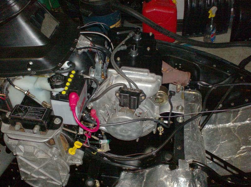

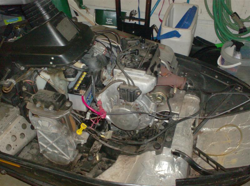

(These are some before and afters of a 95 Indy Lite I picked up for my son, plus a couple of my XLT)

Your sleds look mint under the hood for sure. You could eat off from that XLT. Very nice.
