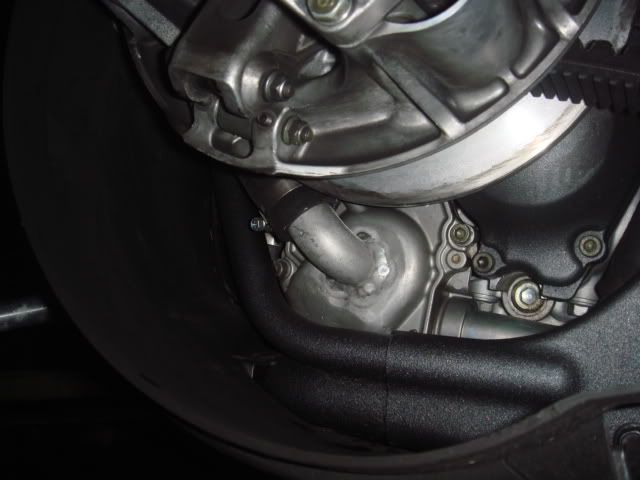

You dont need a new bulkhead.
The modifications are:
Modify battery box
Grind lower engine mounts
modify water pump housing
Then you should manage to mount the apex engine.
All the rst is just making stuff fir within the nytro body, like oil tank etc.
Modify battery box

Really its that simple? Thank you for the picts and time to write up! What do you like about the nypex that you didn't like with nytro or the apex?
Zipperno
- Mar 4, 2008
- 80
- 216
kinger said:Really its that simple? Thank you for the picts and time to write up! What do you like about the nypex that you didn't like with nytro or the apex?
A friend of mine is building one...
Dont get me wrong its still a lot of work, but to get the engine in the chassis is pretty straight forward. Every little thing has to be modified or redone, like cooling, oiltank etc. Forgott to mention you need to modify the front tunnel cooler also, or delete it.
