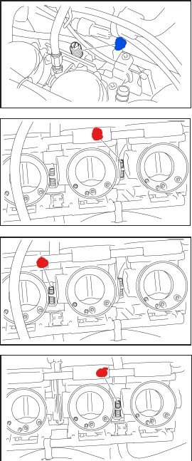

Can you guys tell me what these two adjustments do and how should they be set?

There should be a total of three of them between the 4 throttle bodies and they are used to sync the throttle bodies. Even though it's FI, there is a sync process similar to the old carbs like the RX-1.

ooops...i probably shouldn't have messed with it. Hopefully i remembered to put it back to where it was! Thanks for your help.There should be a total of three of them between the 4 throttle bodies and they are used to sync the throttle bodies. Even though it's FI, there is a sync process similar to the old carbs like the RX-1.

I can only find one?

Blue is Idle adjustment screws. Red is sync screws.
