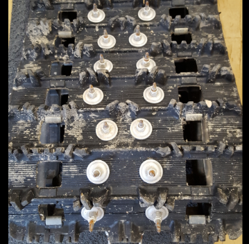

Throwing in 152 studs in my new 144" track and was wondering what stud pattern everyone uses? I have a pattern from Woody's, 4-2-2-4. What other patterns work and what template did you use?
Here is a pic of my old 144" ripsaw 1 track . I swapped out to a 1.5" track this summer and sold this one.

Yup that's the recommended pattern down the middle (nothing on sides). I believe it was 114 studs. Worked great, but decided to go with the 1.5 " track and no studs. We will see how that goes. Hopefully a little better sliding in corners and keep skis down. Took it out yesterday in 14-18" of fresh snow and she went great. Much better than the Ripsaw! Now its raining outside @#$
