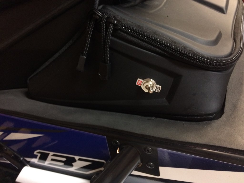

I have a '17 Blue/White SW, so I went with the blue lights. Not sure how they'll go over on the trails with the Deeners, but I've heard they really don't care if you're not being a dick out there. I hooked my tunnel lights to a switch off my pack. Given the battery location and where I wanted the lighting, it worked out best for my needs and was the least invasive to the machine.

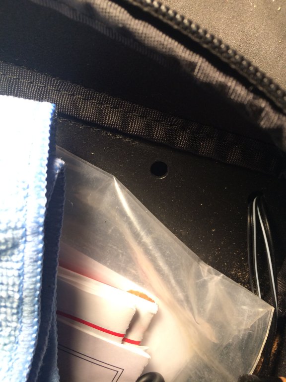

The tunnel lighting proved to be a lot more difficult. I powered up the strips and positioned them by hand to get an idea where I would get the most light thrown, and found the strips wanted to be pretty far aft, and as close to the heat exchanger as possible. I found that my tunnel pack had some vacant rivet holes in it, and the outboard most ones were outboard of the heat exchanger. My apologies, I didn't get a pick of the GROMMETED hole before installing the wiring. If you're drilling your tunnel, or any panel for that matter, you should always use a grommet to protect from chafing and to better keep debris out. I also had to de-solder the connector for the strip lights, so I can get away with the smallest hole possible. I hugged the most outboard side of one of the outboard holes in my tunnel pack, and drilled an 1/8" pilot. Always measure twice to ensure you are not going to drill through your heat exchanger! After confirming from below I was well enough away from the exchanger, I drilled a 5/16" hole for the grommet, ran my wires through, and re-soldered the connector. If you're wondering what surrounds my tunnel pack, I cut a 1/2" Neoprene form to cover my tunnel. Protects it and looks better than the inevitable scuffs the tunnel gets.
Looking in the tunnel pack:
The grometted hole below:
There's a flap in the pack that holds the excess wiring very nicely. I used a pre-wired switch, so no terminals are exposed:

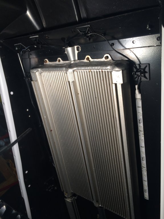

Under tunnel pics and how it looks next.
The strip opposite of the access hole side was run with the wiring going aft, to rout around the exchanger. Again, note the zip tie mounts used to control the wiring. It should probably be loomed, and I intend on doing that too:
The side closest to the wiring access hole. Unfortunately the wiring covers the grommet:

After about 300 miles, I incurred one repair. Not running the wire around the heat exchanger made it susceptible to ice chunks slicing it, which i thought might happen, and did. Not a big deal, the kit provides ample wiring. I soldered and heat shrink-wrapped the cut wire, then ran conduit around it the whole way to the grommet. Worst i've seen so far is some ice hanging from it after another 100 miles.
The LED strips themselves have a rubber-type lens surface to them. They have taken 400 miles of abuse and are still crazy bright. Worst thing that happens there is you get some ice build-up around the strips as they do not create heat to melt it. The 3M tape works extremely well if applied correctly.
I would still fuse the circuit. While the LED's do not draw much current, the short circuit that might happen if / when the wire breaks will. Always fuse for the expected load (plus a bit of headroom) so that a short doesn't make a fuse of your wiring.
