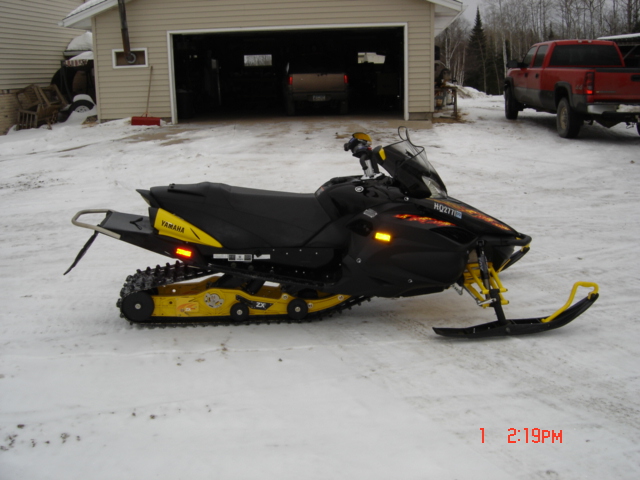

Below are a few pics of my sled with the ZX-2 and one picture of my "Clown Feet" next to a REV.

I love your sled grizz, the only sled with yellow on it I like, I normally hate the yellow but yours looks sweet.
