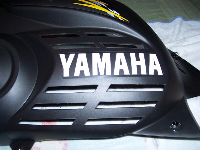

Here is what I did to my 08 RTX. I also covered all the vents including the ones I cut with PET SCREEN. I used silicone adheisive to stick it on. Then I totally closed off the footwell area so the heat would divert out the side panel. It works great and my pant leg and foot are dry.
