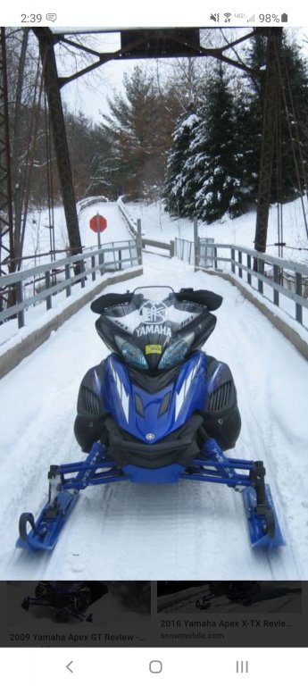

Looks like this one
- 21,818
- 9,379
Looks like this oneView attachment 158066
Its just s standard Apex LE

Thanks now I know which servicemsnual to use to
- 21,818
- 9,379
nothing really that different about them other then the shocks
