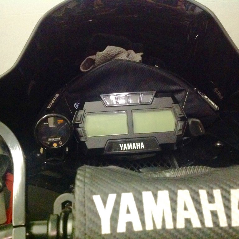

Innovate psb-1 afr and boost in auto meter gauge cup. I like my windshiel bag.

Ya,thats the same gauge EVO has,its a two in one,failsafe,boost and A/F 52mm that is what I will hold out for,now I wonder if that gauge holder you have set up on top of the stock pod,i like that,but does your co. you bought and have before my eyes now,come for just one gauge,instead of the two you have,his gauge is also the AELI am a fan of the AEM failsafe gauge. I like that shows both AFR and boost in the same unit. I also really like the alpha mount that henry sells. I am wondering if he would make one for just 1 gauge rather than multiple. Would look nice and clean IMO.
