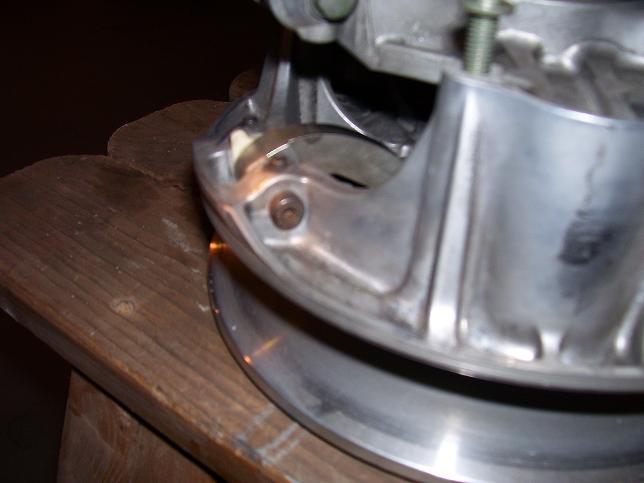

Who made this clutch kit?
Those are Polaris weights mounted on conversion pins to fit the larger inside bushing they use. It is totally aftermarket allowing you to use comet style weights(A?C or Polaris) in a Yamaha primary clutch.
Were do you suggest for me to go for a new bolt? It does have a different helix also, GOLD in color. I hate to have go out and buy a whole new kit.
I'm thinking of going back to the stock set up. Will i beable to leave the aftermarket helix in there or should i replace that to?
not sure what happened here are the pictures again

I am not 100% sure what company uses Comet weights in their kits. Any chance of getting those weights on a gram scale? Do you have stock clutch parts available cus with a little tweaking they can be made to work fine. You have a few options. I have stock primary weights & primary spring for $40 shipped to you & will probably work with that helix.
Hey turk.......The only thing i have for stock items is new nylon washers and the pins. I would like to buy the weights from you if doesnt require much tweaking.
That is a kit from Straightline Performance. Call them, they will fix you up. 651-466-0212
Thanks TURK for the help and everybody else. It is a conversion kit, I just got a kit from GOODWIN PERFORMANCE today with the exact same bolt but it has better washers with bushings. THANKS AGAIN.
Those weights definately ain,t heelclickers. There are 2 things missing, the shoulder & the hole in the tip for tuning. I ran every version of hc out there & those weights are definately A/C or Polaris.
