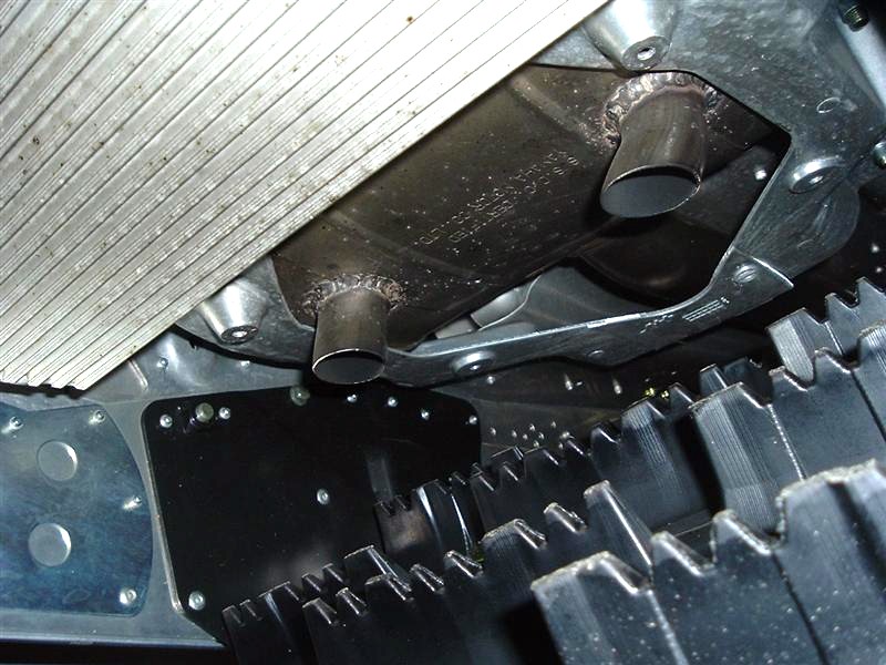

Mtn-Track
My wife wanted more storage on her sled and less on her back. This is what I did to her '07 Vector Mtn.....
The stacks are now in the outer muffler chamber and it sounds and runs much better!
Do you have any problem with the sled bogging in deep snow with this set up?
