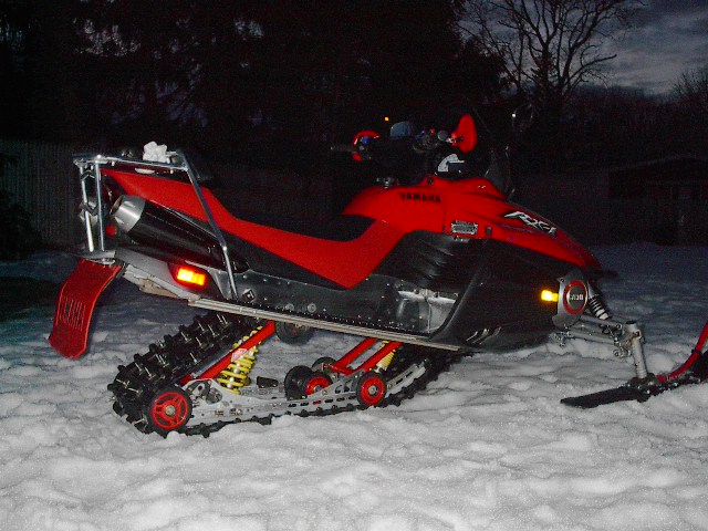

local 25
It raised mine too but not that much when I am seated on it . If I am off it , it looks way higher
It raised the rear of my warrior about 7" and that drops to5" when I am on it.

Wow Local 25! That thing looks really top heavy.

local 25
It is top heavy,im sure i could get it to sit lower if i played with the settings ,but it rides so smooth over ALL the bumps that im afraid that if i play with it it wont ride as nice. Im not a speed demon by no means,so what i loose in handling due to the higher C.O.G i can live with. Also i am 220 lbs with all the gear so it does sit a little lower when im on it.

You can easily set it up to ride a bit lower....all you would do is a bit less pretension on the rear shock and slide the bottom adjustment shaft ahead to get more stroke from the shock.....The skid is highly adjustable......I was a bit disappointed at first, until I did some experimenting and now it outright rocks…..Remember though if you set your ride height to low….when you slam the bumps….you will have less travel…..Now after having said all that….I did loose charge in my rear FOX Zero pro shock today….A bit premature I think… :itchy: ..But never the less I still love the M-10…I would have gotten rid or my Rx bye now if I never put in that skid…..
