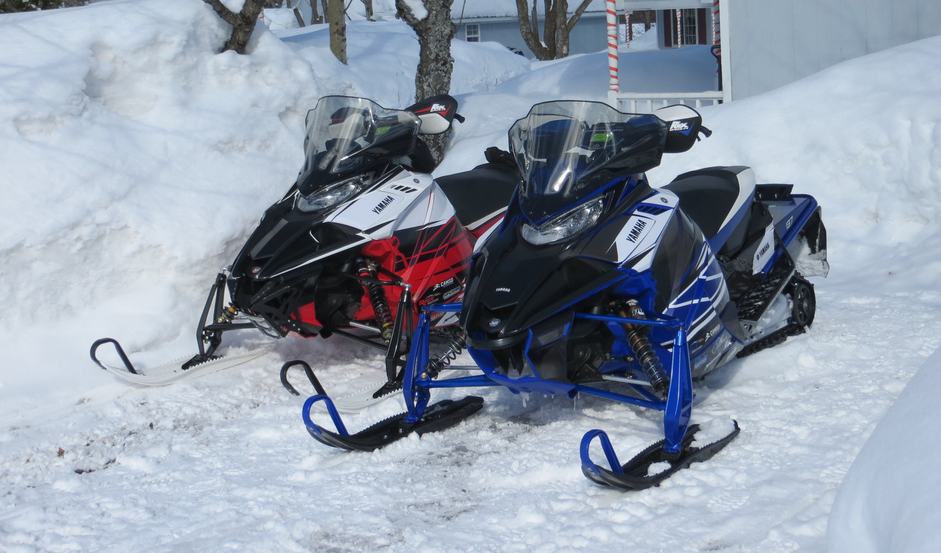

I've been running the Medium Sport Windshields on our SW's and haven't had any problems with the wind buffeting at speed. I think these look good on the sled and still offer decent wind protection. They've got the holes marked on the sides of the windshield if you'd ever want to install mirrors.

I think they look really nice on these sleds AND offer much better protection.
