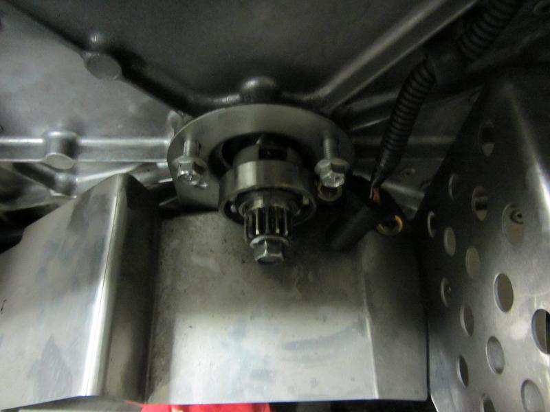

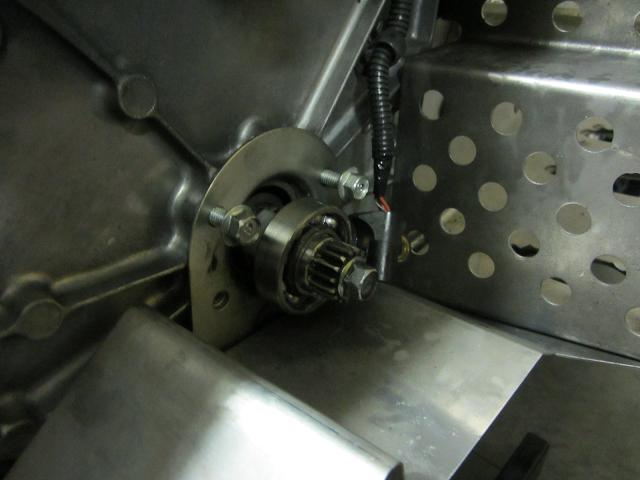

So I had the secondary removed and decided I would clean and grease the driveshaft bearing. So I sprayed it with wd 40 and decided I would rotate the track to get the crud cleaned out. I have the skid removed because I had my shocks revalved and the star suspension kit put it, so when I rotated the track the driveshaft shifted and popped out the side toward the secondary clutch, I just pushed on the shaft back towards the chaincase, but with this happening could it have affected anything in the chaincase? I have never ripped into the chaincase so I am not sure whats all on the other side of the driveshaft on the chaincase side.

if it went back in place you should be fine, it just fits the spline on the lower gear on the chain case side.

if you have never been in the chaincase you might want to look in there if the speedo side popped out that easy, sounds like you have the infamous broken bolt in the lower chaincase gear...

yep, your bolt is broken, that along with the set screws on the bearing are what hold the drive shaft in place. If you have everything torn apart already, might as well replace the bolt.

Put a new bolt with the spacer...problem solved.
