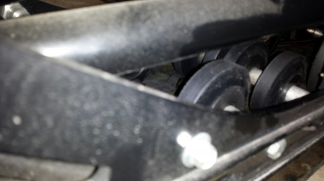

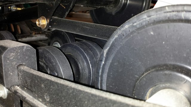

I added wheels to my skid for asphalt, but they are the smaller diameter ones that come with aftermarket race suspensions. Might try them in snow. The bolt holes are already in the skid for the smaller wheels like I used. Only had to drill 2 holes up front for an anti-stab axle with wheels.
