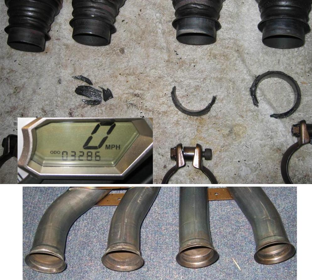

Most people are seeing them go at 2500-3500 miles. Mine went at 8600 and I have 3000 on the new set with no problems yet.
When it begins to backfire on decel its time for new ones.

05 warrior 6200 miles 1 was 1/2 gone and 1 was 1/4 gone other 2 were in good shape, nothing wrong with y pipe

Replaced mine at 6000kms. Two were completely gone, 1 was 1/2 there and the right side cylinder was completely intact. No backfiring, just heard what sounded like a header leak about at about 5000kms

'07 Attak GT with 2,300 miles 1 donut gone.....2 badly worn..and 1 was ok. My left "Y" pipe was also cracked. Everything was replaced under YES warranty.
I say check it when you can. Better to find a problem now and fix it..then have a problem out on the trails...not to mention you can cause more problems ($$) if you dont replace that cheap donut that needs to be replaced or let it go and have to eventually replace a Y pipe ($300-400).

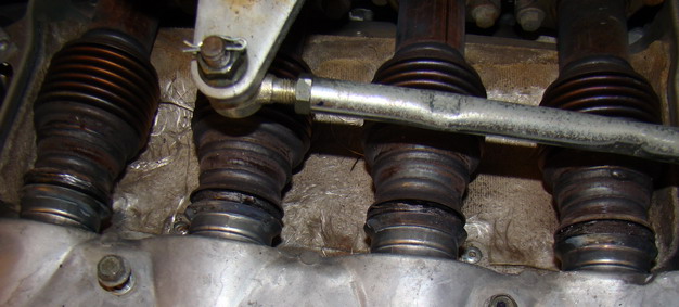

When mine went bad, I had a cracked titanium pipe. they were not available then, and the cost was about $250 each. RX1 stainless pipes are about $150 each, if I remember right.
I bought a set of used RX1 pipes, and had a muffler shop add about 1" to the length to match the Apex pipes. I paid $150 for 2 pipes, and $20 to the muffler shop. Stainless will not crack as easily, and could be welded. It's a big deal to have titanium welded.

Mine failed at 7700 km. No backfiring, but the sound of the exhaust changed quite a bit. This was something I was paying attention to from other posts and caught the failure before the Y-pipes were affected. To bad I never noticed the post on the jack-shaft bearing.
