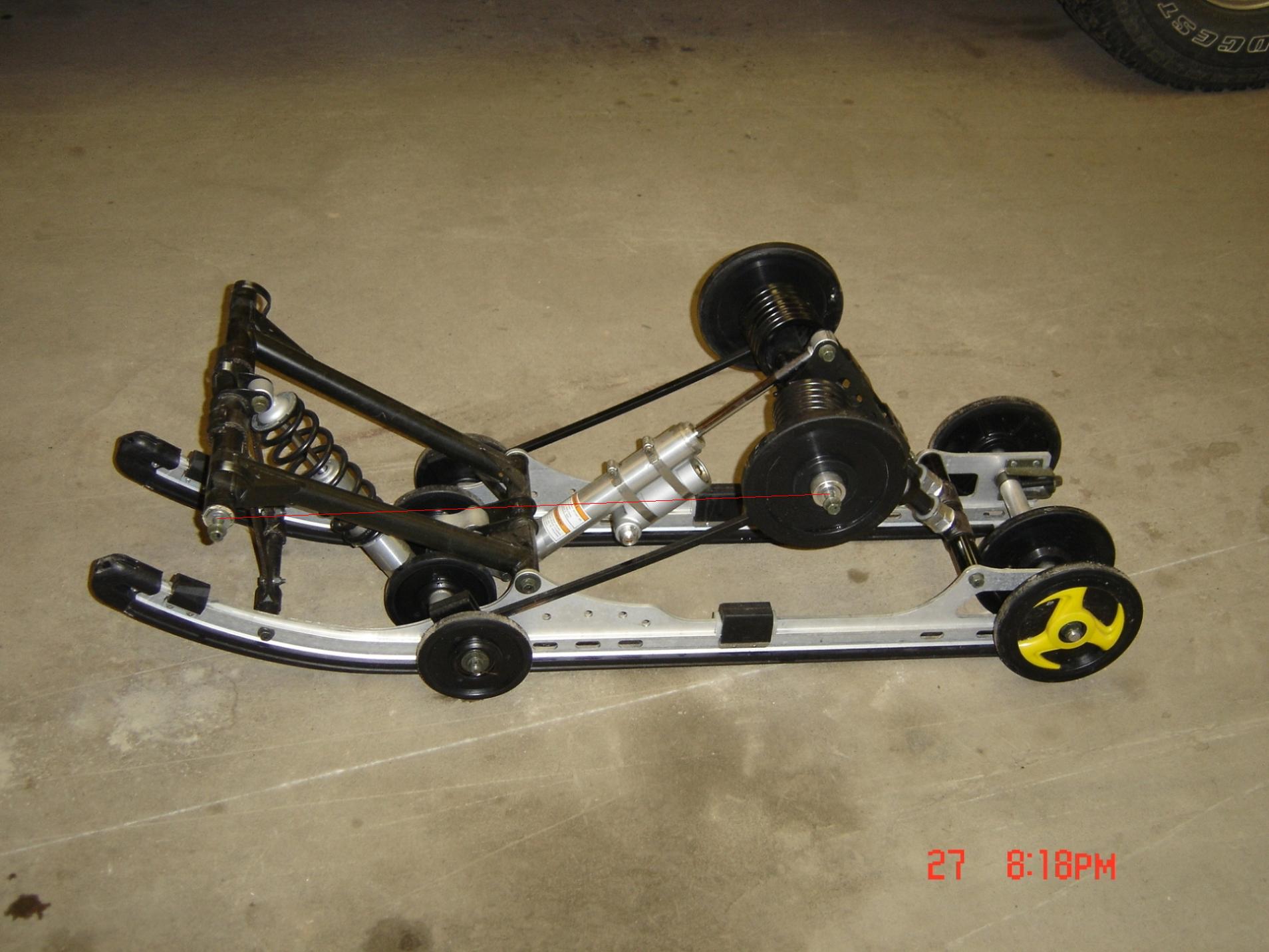

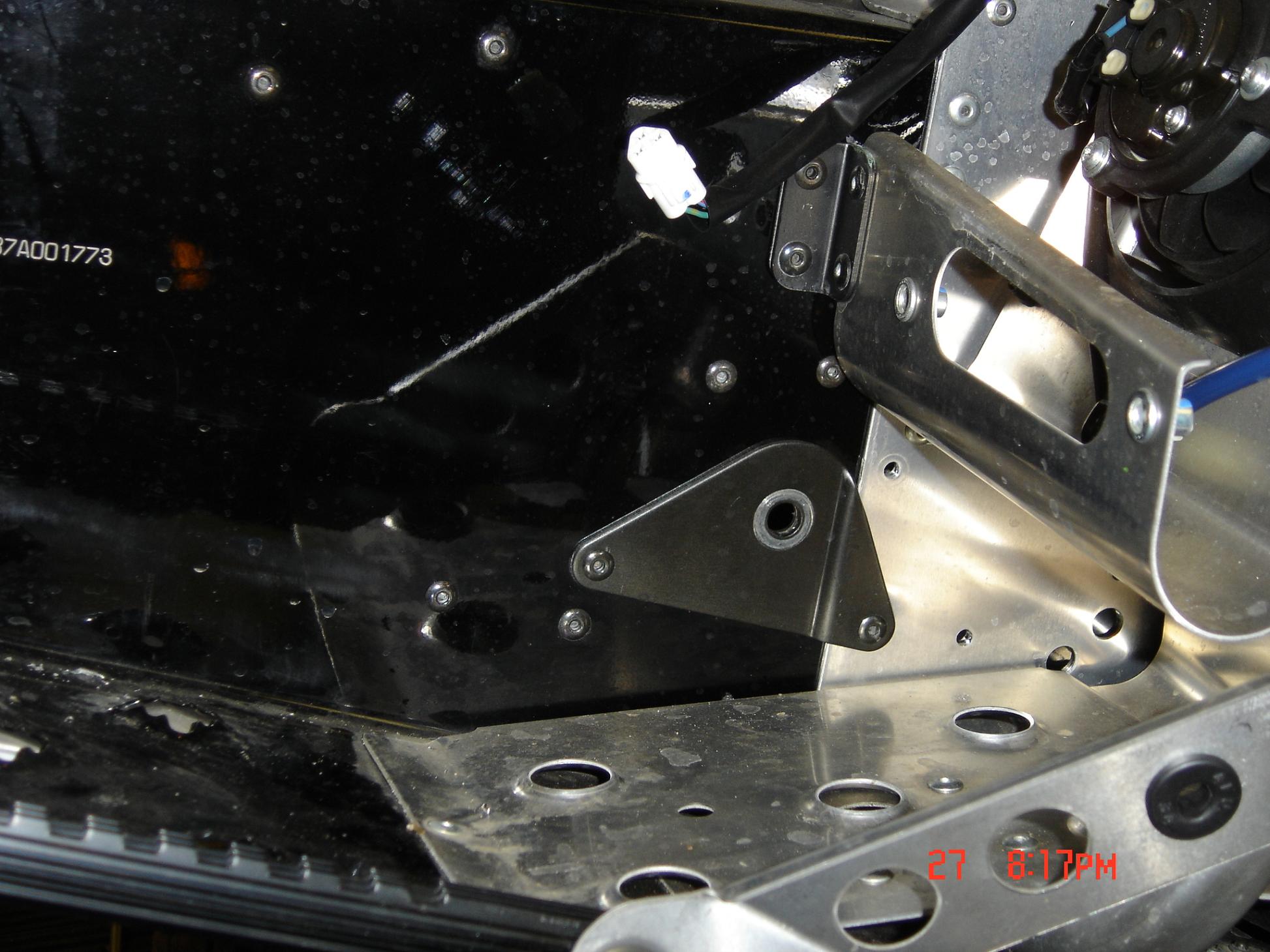

If you have access to a digital camera and tape measure, I'll try to help you out. I am positive the skid from my 07 is the same as the 09. Take a picture of where the front arm bolts in. I am thinking this is the same on both sleds.
Check the front mount reinforcement locations and compare to my pictures. I believe these should be the same. Next, compare the rear mount holes. On my RTX, the skid was originally mounted below the running boards on the two drop brackets. This is where I think there is going to be a difference. If you have drop brackets similar to mine, measure the center to center distance betweek the holes for the front arm mount and the rear arm mount (lower hole in the drop bracket.) I'll try and measure this C-C tonight and let you know in the morning.
The pictures are a little out of order but you should get the jist. Clicking on them will give you a larger view. Let me know if this helps.

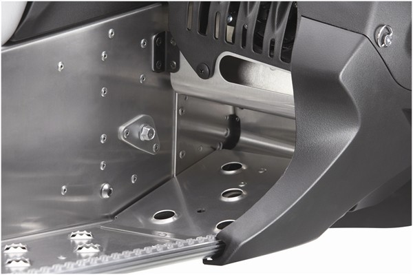

Yep, the fronts are different. I thought they were the same for some reason. I took one picture off the Yamaha webpage of an Apex and compare it to my RTX. The RTX does have the pro-action mounted farther forward. If the rear drop brackets were the same and in the same location, you could use the rear as is and drill two new holes for the front. You could but the stamped steel reinforcement brackets for the RTX or just make your own.
