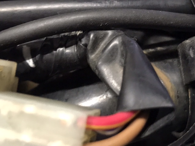

My son has a 2007 Yamaha Phazer, he was in Wisconsin and the machine would not start. It was the relay I believe.
Anyhow the ignition switch was cut out at the small square connector block that connects it to the harness. Now there are the 4 wires from the switch and the 4 wires to the harness, I am trying to figure out which wires mate to each other. I think someone was trying to hot wire it. Thank You very much for any help you can provide. I have a schematic but I can't tell the connector direction.

Sure I can help. Phazer is in my shop right now. Take some pics. Wires are colored though so not understand problemMessage @cannondale27 , he knows the Phazer really well.

The wiring from the key switch is a Red, Red white, Brown and Brown /white. The harness where it connects to is L/w, Red/yellow/,Brown and Black.

You have Pictures you can attach?
I get it wires were cut right at plug so you can’t see them?

That's correct the male and the female connector was removed.
Here
Redwhite-Bluewhite
Red-Redwhite
Brown-Brown
BrownWhite-blackwhite
Red-Redwhite
Brown-Brown

Thank You so much. I will get out to the shed and get on that today.
Crazy the wires don’t match. Japan logic I guess. Way over my head as to why. Hope gets you going.
